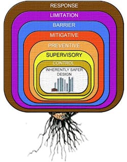

ONION SKIN MODEL
Figure 1. Layers aren’t completely independent because they all attach to the base, whose integrity depends upon an adequate functional safety management system.
COMPROMISED LAYERS OF PROTECTIONThe onion skin and Swiss cheese models of incidents are ubiquitous. These models typically serve as an analogy for layers of protection. On first glance, each shows the layers as independent of each other, i.e., the failure of one layer doesn’t impact the other. On further study, the graphics portray much more.The onion skin visualizes the sequence of barriers that control, prevent and mitigate major accidents (Figure 1). Layers of protection are as independent as the layers of an onion. However, as any cook knows, the structural integrity of the onion depends upon keeping the layers attached to the base. The onion layers originate at the base and, without it, they fall apart. The integrity of the base of the layers of protection is determined by the safety management system applied to reduce human error and to sustain the fitness for service of safety equipment.James Reason’s Swiss cheese model [5] has been adapted to illustrate each barrier as a cheese slice possessing holes that represent deficiencies in barrier performance due to random and systematic faults (Figure 2).Seemingly independent systems can fail due to common systematic mechanisms that degrade or disable multiple similar elements. The graphic emphasizes that barriers aren’t perfect over their life and that an accumulation of deficiencies (an increasing number of holes in each cheese slice) raises the likelihood that holes will line up, thus allowing an event to propagate past the barriers. The holes open and close dynamically as management systems identify and correct faults, so the better managed the barriers, the fewer, smaller and more transient the holes will be. Many human-factor issues impact every layer. Resources and infrastructure typically are shared; similar equipment, procedures and people are used to design, operate, maintain and test barriers. The more complex or specialized the layer is, the higher the potential for human error. A company’s culture toward manual operation of control loops, bypassing safety instruments or continuing operation with known faults can result in multiple risk sources being turned over to operators across a facility. The layers of protection only can be as strong as the rigor applied in identifying and minimizing human errors and systematic failures.
