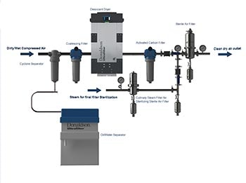

Compressed Air Treatment
Figure 1. Proper treatment typically requires a train consisting of filters, dryers and separators.
Prefiltration in the utility room usually calls for:
• a coalescing filter (1–5 µm) to remove oil and protect the refrigerated dryer;
• a refrigerated dryer to condense and remove water content;
• a cyclone separator to mechanically drain remaining liquid condensate; and
• a coalescing filter (1–5 µm) to eliminate aerosols.
Point-of-use filtration before compressed air contacts a product typically requires:
• an adsorption dryer to remove water vapor; and
• point-of-use filters (0.2 µm) to take out contaminants potentially picked up in system lines.
