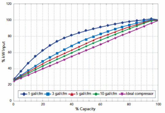

Power Consumption Versus Storage Capacity
Figure 1. Using larger storage makes lubricated screw compressors run more efficiently in load/unload mode.

Lack of storage. Too often a system doesn’t include enough storage receiver capacity. The presence of one or more large storage receivers near the compressor room helps the compressors maintain stable system pressure and run more efficiently. Receivers store a significant quantity of air that can prevent the system pressure from falling or rising too fast. This simplifies compressor control and could very well allow one or more compressors to turn off when not required instead of running unloaded, wasting power.
If a compressor is running in load/unload mode, the presence of large storage will make the compressor more efficient by reducing the frequency of load cycles. Figure 1 shows the effect of adding storage to lubricated screw compressors. As more storage is available, the power consumption at part loads decreases.
How large is “large?” Try to install 5–10 gal of capacity for each cfm of trim compressor capacity. (A trim compressor is one that operates at part load.) So, for a 100-hp compressor, put in between 2,000 and 4,000 gal. Yes, that’s a large tank but it usually will pay for itself many times over.
