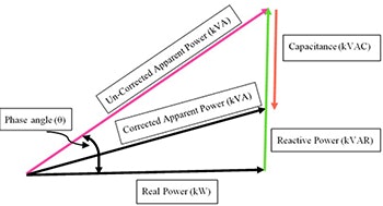

Total apparent power in electric circuits is the sum of the “real power” and “reactive power,” as total power = real power + reactive power. Real power is able to do work, measured in kW. The reactive power is consumed in energizing a magnetic field, denoted as kVAR. Electric motors are the main users of reactive power, because of the magnetic field generated in their windings. The PF is the ratio of the real power (Pr) to the apparent power (Pa), or PF = Pr /Pa.
Real power and reactive power are 90° out of phase, so they have both magnitude and direction — i.e., they are vector quantities. Their vector sum is the total apparent power, denoted as kVA. We illustrate this as the PF triangle shown in Figure 1.
Power Factor Triangle
Figure 1. Simple trigonometry can be used to determine power factor.
The beauty of using the PF triangle is that the standard trigonometric relations (sine, cosine, etc.) enable you to solve the elements of the triangle given the minimal information of any right triangle. The PF is equal to the cosine of the phase angle.

Installing a capacitor bank will increase the PF. The capacitors function exactly opposite to the reactive power vector, reducing the total reactive power and the phase angle, and shortening the apparent power vector as seen in Figure 1.
Using the geometry of the PF triangle, we can readily calculate the impact of a capacitor bank, and the resulting demand savings in an electric bill. This is how the IAC determined the savings for the plant mentioned in the first paragraph. Appendix 1 (see below) contains a detailed calculation of a similar example.

We then determine the uncorrected phase angle and reactive power values in the triangle.
Phase angle = arc cosine (0.82) = 35°
Reactive power (kVAR) = (tangent 35°) × 932 kW = 651 kVAR
When the capacitors are sized to make the PF = 0.95, the phase angle will be 18°, and the reactive power is 306 kVAR. The difference between the original reactive power and the corrected value is the result of adding capacitors.
651 kVAR - 306 kVAR = 345 kVAC
