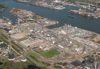

For example, DuPont, Wilmington, Del., made a significant process change in the Delrin Chemical Area (DCA) at its site in Dordrecht, the Netherlands (Figure 1), which is home to nine manufacturing plants where refrigerants, synthetic resins and powder coatings are produced. The DCA is the largest consumer of steam at the site. One of the main steam consumers in the DCA is a concentrator column that reworks a number of recycle formaldehyde/water steams to give a formalin solution for re-use in the Delrin (an acetal resin) process. The excess water goes to a waste treatment facility.
Dutch Site
Figure 1. The Dordrecht complex in the Netherlands includes nine manufacturing plants and is DuPont’s largest site in Europe. Source: DuPont.
