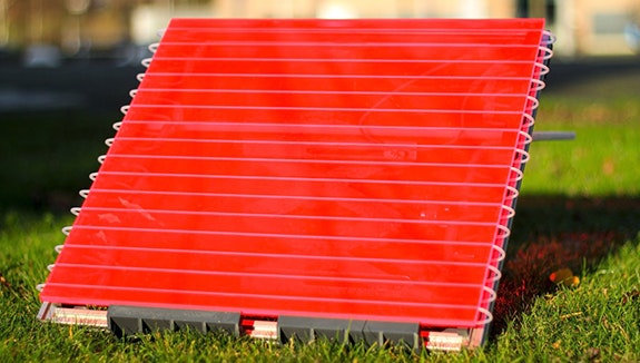

Dutch chemical engineers and chemists have developed a stand-alone solar-powered mini flow reactor capable of producing fine chemicals in remote locations on earth — and, possibly, further afield.
“Our dream is to see our system used at a base on the Moon or on Mars, where self-sustaining systems are needed to provide energy, food and medicine. Our mini-plant could contribute to this in a fully autonomous, independent way,” says Timothy Noël, professor in the flow chemistry group of the Van't Hoff Institute for Molecular Sciences at the University of Amsterdam, the Netherlands.
The prototype reactor consists of a scaled-up luminescent solar concentrator photo-microreactor (LSC-PM) which converts direct and diffuse sunlight energy to a wavelength range that matches the absorption spectrum of a photocatalyst and, subsequently, guides this fluorescent light towards embedded reaction channels to drive photochemical transformations.
The reactor itself is based on a 15-mL LSC-PM module that started life as two 4-mm-thick polymethylmethacrylate (PMMA) plates each with an area of 470 mm2. Both plates were first doped with BASF’s commercial fluorescent dye Lumogen F Red 305 — chosen for its high fluorescent yields and excellent photostability. Then 16, 3.2-mm-diameter grooves were drilled along each plate. After gluing perfluoroalkoxy (PFA) tubing of the same external and internal diameter into each one of the grooves, the two halves were sandwiched together.
A pump introduces the reaction mixture into the reactor channels while an LSC guides light towards them. The incoming liquid flow is merged with a flow of oxygen governed by a mass flow controller.
A light sensor attached to the edge of the LSC-PM is monitored in real time, with a control system tweaking the flow rates of both oxygen and reagents to match the current light intensity. An experimentally established conversion correlation maintains production quality, no matter the weather.
