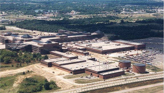

The following example, from the 2-million-ft2 corporate R&D complex for Chrysler Motors (now Stellantis) in Auburn Hills, Mich., illustrates both operating and capital savings. Chilled water TES was built into the facility’s central cooling system during its initial construction to serve a projected peak cooling load of 16,000 tons. A conventional (non-TES) chiller plant requires 17,700 tons of capacity (including spare capacity). However, with 68,000 ton-hrs of CHW TES included, the chiller plant capacity was reduced to 11,400 tons. The 6,300-ton chiller plant capacity reduction, offset by two 3.1-million-gal TES tanks, produced a net capital cost reduction of $3.6 million. There was also a $1 million annual energy cost saving due to reductions of 7,600 tons of on-peak cooling, and 5.7 MW of electric demand. The two above-grade, welded-steel TES tanks also provide emergency fire protection.
