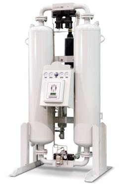

"HEATLESS" DESICCANT DRYER
Figure 1. Unit uses compressed air to approximately 15% of its rated capacity to regenerate desiccant. Source: Precision Pneumatic Products.
