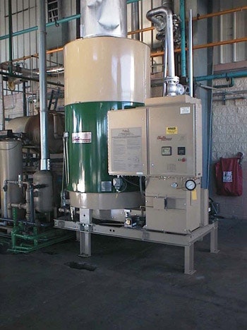

STEAM GENERATOR
Figure 1. Coil-type boilers start up quickly, generating steam in as little as 10 minutes.

A third type of boiler, technically a forced-circulation water tube boiler but commonly referred to as a steam generator, uses a mechanical water pump to control and circulate the internal water flow (Figure 1). Tubes normally are configured in a coil shape, so such units often are called "coil type" boilers.

Startup. If you don't need steam 24/7, you'll probably want to shut down your boiler at times. Do you need a unit that can stop and start in short order, or is a slower startup acceptable? Every time you start or idle a boiler just to keep it warm, you're wasting fuel. If quick startups are required, consider a steam generator. These efficient boilers can go from startup to steam generating in about 10 minutes.
