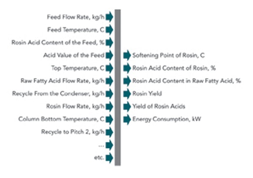

Inputs and Outputs
Figure 1. Nonlinear models rely on numerous inputs to provide a variety of outputs.

We identified a number of variables to use for developing the nonlinear models, and had production data from January 2009 onwards. Production data tend to be dilute in information and often contain misleading observations. So, we carefully selected data, excluding some observations from the model development set. Doing so enabled us to make more progress in a shorter time period — the model development project started in February 2011 and finished in June. Figure 1 shows the kinds of variables included in the models. Testing indicated the models were good quality.
