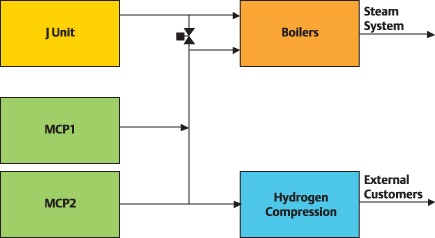

Hydrogen Flow
Figure 1. All hydrogen from mercury cells and some from membrane cells typically go to boilers. Some membrane-cell hydrogen is compressed and sent to external customers.

Previously, only the older J Unit provided hydrogen for external customers. Switching to cleaner mercury-free hydrogen produced by the MCP's advanced-membrane-cell electrolysis method enabled us to furnish higher-quality product — and use the J Unit's hydrogen to power our onsite boiler (Figure 1).
