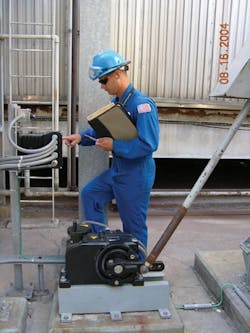

Author Rutkoski examines the ABB Contrac Modulating Electric Drive. Linkage from the drive lever arm to the damper extends upward (left). The PEU is conveniently mounted on the post near the drive (right).Actuator features precision
ABB’;s Contrac electric actuator provides intelligent, or “smart,” modulating action to position the damper precisely within its operating range in response to a 4-20 mA DC control signal. Different models are available for torque requirements ranging from 80 ft-lb to 12,000 ft-lb. Startup torque is 1.2 times rated with “break-away” torque being twice the rated torque. Model RHD-800, installed at Equistar, has a rated torque of 600 ft-lb.Manually adjustable mechanical stops on the drive permit the user to set travel limits on the lever arm. Equistar uses this feature to set the minimum damper opening – essential when controlling manually. The actuator level arm is set to travel 90° in 10 sec. An integrated motor brake enables the drive to hold damper position in the event of power failure or switch-off.The drive unit can monitor several operational functions, including damper position, frequency of motor reversals, and actuator internal temperature. Values are stored in the electronics unit for performance analysis. ABB Smart Vision Interface Software, an available option, can be loaded on a PC to help in such analyses.A smart moveThe key to “smart” operation of the Contrac actuator is the configurable, microprocessor-based Power Electronics Unit (PEU). It is a separate unit that can be field-mounted near the actuator (Figure 3) and provides digital control and acts as the interface between the actuator and the DCS. When the DCS control signal calls for continuous positioning, the PEU varies the actuator motor frequency, without stepping, until the actuator moves the damper to a new position at the right torque that satisfies the setpoint value.To configure the PEU for a specific actuator application, such as the damper drive, the electronics unit has a local control panel (LCP), located on the front of the unit under a protective cover (Figure 4).Figure 4. Local panel and power unit
