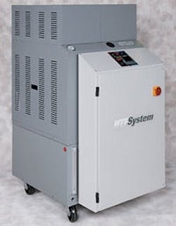

Mokon has redesigned its HF-2 Series Heat Transfer Fluid System
Mokon has redesigned its HF-2 Series Heat Transfer Fluid System. The system is updated with improved performance, energy efficiency and reduced space requirements for large flow and higher heating capacity applications. The system provides accurate temperature control up to 600°F.
The HF-2 Series features a 12 kW heater canister mounted in the traditional Mokon “horizontal forced fluid flow” design. This heater design, along with an all-welded construction, reduces internal piping and limits potential leak points. The system also features Mokon’s “continuous flow” cool oil reservoir design to ensure accurate and safe process temperature control and cooling.
Mokon’s HF-2 Series systems are available in single- and dual-zone configurations with pumping capacities of 40, 60, 90 and 120 gpm and heating capacities up to 144 kW.
All Mokon HTF Systems are designed to meet and exceed NFPA 79 (National Fire Protection Association) electrical standards and include an auxiliary redundant heater contractor for over temperature safety and a UL labeled electrical sub-panel as standard.
