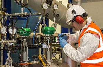

Regular Monitoring
Figure 1. Maintaining optimum performance requires effective ongoing maintenance.
