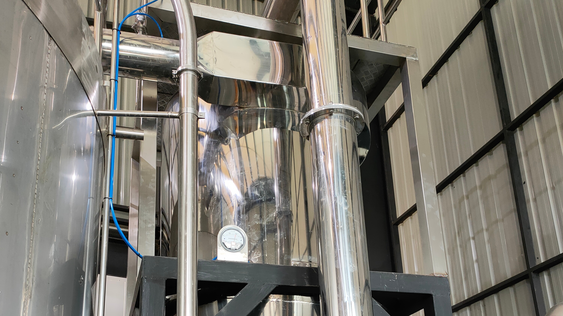

For a continuous process, many operations use spray dryers. A design with a high-speed rotary atomization can produce a powder with nice spherical particles with low residual moisture content, a narrow particle size distribution with no oversize material and a typical mean particle size of 5-20 µm. The design can also handle abrasive particles.
Horizontal paddle dryers are suitable for batch operations. These units can operate at temperatures up to 650° C with very close wall tolerances of the paddles to avoid crust formation on the dryer vessel walls. Paddle dryers can also operate at low temperatures under vacuum drying conditions. The paddle designs convey the solids forward and backward creating a 3D turbulent zone for optimum mixing/drying. Paddles can also be heated for added heat transfer to the powders.
Batch dryer designs also are available as vertical conical dryers. In this type of design, helical arms move the solids upward and downward for 3D mixing/drying with very close wall tolerances. The helical arms are also heated for additional heat transfer to the product.
Fluid Bed Dryers
For lithium carbonate and lithium hydroxides, fluid bed dryers are another option. The designs are normally stationary bed with high air flow rates for efficient heat transfer and drying. Multi-zone operation with drying and cooling enhances the operation with a smaller footprint.
All of these dryer types are fitted with integrated dust filters to eliminate emissions and recover additional product. Electrolyte solvent recovery systems are also installed for condensing and reuse of the solvents back into the system for a closed-loop design.
As for installation and degree of complexities, spray dryers and fluid bed dryers require large footprints with additional heaters, fans and external cyclones or bag/dust filters, but they offer the benefit of continuous operation. Batch dryers are easier to install yet require either upstream buffer tanks or a second dryer for continuous operation.
