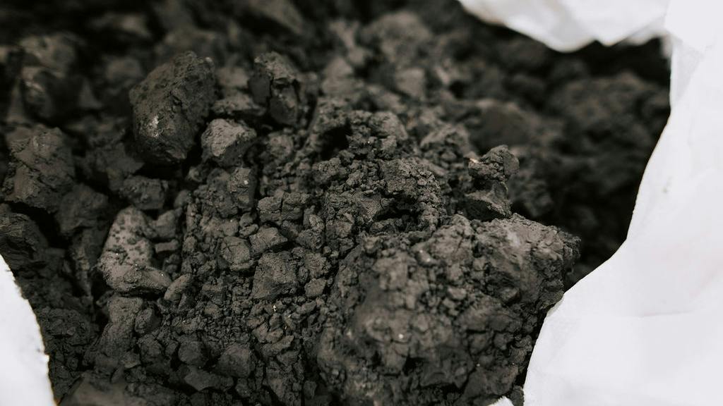

Black mass isn’t as grim as it sounds. It’s the material left over at the end of the lithium-ion battery production process. Recycling lithium-ion batteries requires processing and drying of the black mass downstream of the mechanical shredding-crushing-granulating operations.
Black mass contains the cathode active material (lithium, nickel, cobalt and manganese), anode active material (graphite, silicon and lithium) and residual metals (copper and aluminum). Drying the material is critical for several reasons. First. and most importantly, is safety. After the mechanical operations, which I discussed in my last column, the black mass contains electrolytes (solvents) that are hazardous to both operators and the plant environment. Secondly, a dried black mass allows for improved separation of the active materials in the subsequent operations. This means drying or evaporation of the electrolytes allows for materials recovery and reuse while eliminating emissions to the external environment.
