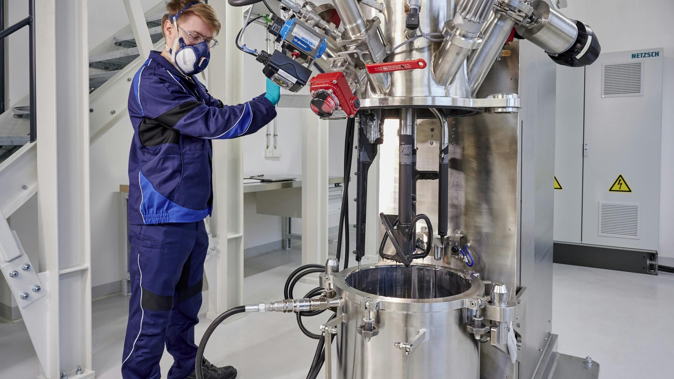

Mixer Options
Battery processors typically use planetary mixers for electrode slurry mixing. For most applications, these mixers include two or three multi-hinged blades. The material flows up and down as well as around the inner cylinder when the paddles are moving in both revolution and rotation at the same time, which quickly produces the mixing effect. There are many blade-design options, which operators select based on viscosity testing results and coated-layer thickness reproducibility.
There are several newer alternatives to planetary mixers that are currently in the market. These have the benefits of continuous operation as well as being able to meet the dispersion requirements for nano-scale active material ingredients.
The planetary centrifugal mixer is a device that can agitate materials without using agitator blades. These mixers have a revolution with a centrifugal force, a rotation and a tilt resulting in a 3-D flow. It is also possible to operate the mixer under vacuum, which can improve the mixing results.
A second alternative is a thin-film spin high-speed mixer. In this operation, the thin-film spin design involves a high-speed revolution of the rotor, which causes materials to form a thin film along the walls of the vessel. The slurry is fed in from the bottom and discharged from the top or the side.
The choice of mixer depends upon the components to be mixed as well as the final properties of the type of lithium-ion battery, such as prismatic or pouch designs, solid-state, sodium-ion and lithium iron phosphate, to name a few. Regardless of the selected mixer, battery processors must measure the output quality of liquid density, solid density, shear rates, yield stress and thixotropic behaviors. This will optimize the mixing recipe, which processors can then correlate to the electric parameters of electrode sheets in the battery.
