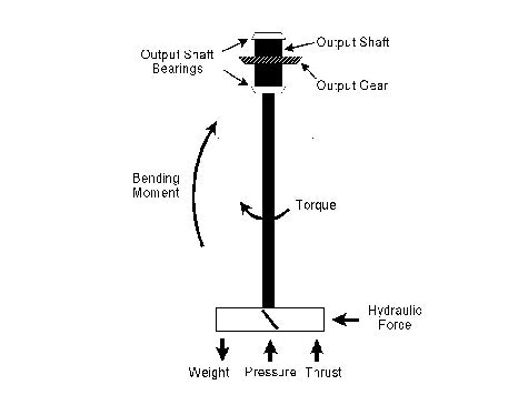

The “wetted” parts of the mixer must be designed to handle mechanical loads, process conditions and potential vibrations. Most mechanical loads come from an interaction between the mixer and the fluid (Figure 1). Obviously, a force is necessary to rotate the impeller. That force is represented by a torque load transmitted by the shaft from the drive to the impeller. Besides the fluid forces that resist the rotating impeller, moving fluid creates random hydraulic forces that act perpendicularly to the shaft.
These forces create a bending moment on the shaft. A typical cantilevered shaft, which is supported only by the mixer drive, can experience significant bending loads. So, selection of shaft diameter requires consideration of both the torque and bending loads.

Figure 1. Various forces contribute to the load that a shaft must contend with.

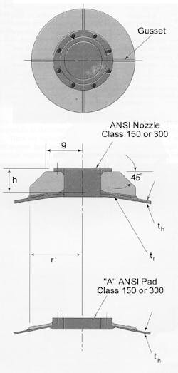

The nozzle or pad mounting for a mixer (Figure 2) requires that support be distributed across the head of the tank. A nozzle uses gussets to provide sufficient stiffness and support. A reinforcing or stiffening plate, called a “skull cap,” often is formed to the head of the tank to increase stiffness around the nozzle or pad. Without this reinforcement, the head must be thicker and more expensive. The reinforcement also reduces the possibility that the outer ends of the nozzle gussets can cause fatigue cracks where stresses are concentrated. Within practical limits, the better the mixer is supported, the less likely other failures will occur.
Figure 2. It is crucial to provide adequate stiffness and support.
A flexible or weak mounting will lead to other mechanical problems. Deflections in the mixer mounting may result in a bent shaft or worn shaft bearings. A flexible mounting also may allow vibrations that will prompt premature seal failures. A weak mounting will decrease the first natural frequency of the mixer shaft — and thus may cause critical speed problems not anticipated in the mixer design.
