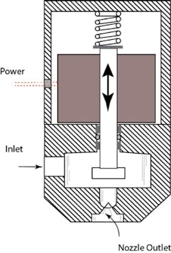

Pulsed Nozzle
Figure 6. A close-coupled solenoid enables rapid opening and closing of the outlet to control the fraction of time spraying occurs.

Pulsed Single-Fluid Nozzle
Pulsing a single-fluid nozzle — that is, rapidly activating and deactivating the nozzle to control the fraction of time it is spraying — enables independent control of flow rate and pressure. A close-coupled solenoid valve acts on the nozzle (Figure 6). When the solenoid retracts the plunger, liquid can spray. The frequency of pulsation varies between the products and manufacturers; it can range from 10 to 200 times per second. The actual flow rate as a percentage of the maximum flow is set via a control unit that supplies the pulsing power to the solenoid valve. The supply pressure must be controlled to set the sprayed flow.
This technology is a relative newcomer to spray options — introduced less than ten years ago. The pulse-width-modulation (PWM) system of spray nozzles (Figure 7) is rapidly gaining traction. It provides a means to maintain the average drop size, spray angle and spray pattern at reduced flows. PWM nozzle systems with controllers provide many advantages for certain applications. For example, adjusting the duty cycle can control the amount of material sprayed onto a conveyor as its speed changes while maintaining the spray parameters.
