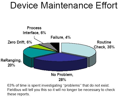

A relatively recent survey indicates that almost two-thirds of instrument maintenance is unnecessary (Figure 2). Integrated digital instruments make it possible to eliminate the “Routine Check” and “No Problem” maintenance requests by either displaying the device status directly on the operator console or alternatively through a mouse click to either a status screen or pop-up with the device’s operating status.
Figure 2. Almost two-thirds of maintenance time is spent investigating “problems” that do not really exist.
In addition, because new field devices are also inherently so reliable and are connected to the host system via digital communications, when maintenance is necessary it is possible to perform as much as 80% of the required work remotely from the appropriate maintenance work station. The “Process Interface” and “Failure” problems (Figure 2) still require that a maintenance mechanic physically work on the device in the field.
