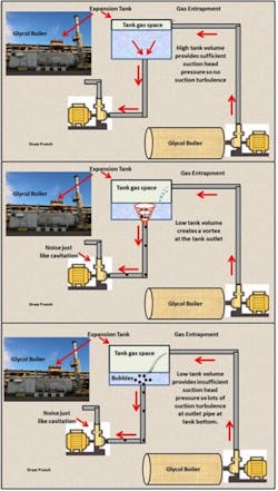

Systems that have tank/pump/boiler combinations, such as glycol systems for heating downstream processes, create cavitation issues that are not always related to the pump. These systems rely on raised tanks to feed pumps pressure and gravity. An expansion tank above a glycol boiler is an example of a system that creates bubbles at times that can create cavitation sounds. Figure 4 offers examples of how cavitation can be falsely attributed to pumps.
Figure 4 illustrates three operating snapshots of a glycol heating system. These pressure vessels usually have a blanket, such as natural gas, which can be entrained in the outlet flow. The top diagram in the set shows a system in balance with the pumps feeding the expansion tank — being in harmony with the liquid, leaving it to feed the pumps below the vessel. The key factor enabling this balance is a float level control.
The vessel feed pumps, which always use a variable frequency drive (VFD), speed up as the level of the expansion tank lowers. The pumps below the expansion tank are always running according to the set point of the downstream requirements and then draw from the expansion tank.
Although they are also VFDs, they are usually at a constant rate but can be set to react quickly to downstream process requirements. The expansion tank is so small in volume that even small fluctuations caused by level controllers that manage feed pumps can get out of sync with suction pumps when the downstream process starts to rock and roll.
Bubbles in the expansion tank form at the vessel outlet if the level controller is set too low before the feed VFDs speed up or if the feed VFDs are set to ramp up at a slower rate than required.
The middle diagram of Figure 4 shows that at low tank level a vortex can form and cause gas entrapment of bubbles that then reach the pumps below, creating cavitation sounds. The lower diagram of Figure 4 shows that a vortex didn’t form because the vessel level is too low. It may have been there at a slightly higher vessel level but dissipated when it reached a lower level. In this example, the small size of the expansion tank made it very difficult for the process engineers to sync the VFDs with each other because of VFD card communication delays.
The lower diagram represents an actual situation I experienced when working as a senior lab tech at an oil company camp. It was a tough problem to troubleshoot because the head office, located 435 miles away, kept insisting the pumps were creating the cavitation. Three pumps were connected to a common header below the expansion tank that fed downstream parts of the process. I suggested a very simple fix for vortexing in expansion tanks: install baffles over the outlet at the bottom of the tank.
The entire system had to be purged to enter the expansion tank for a process engineer and myself to examine the actual as-built exit piping. We then fabricated a simple 2-ft-high baffle on four legs and installed it above the exit pipe. The baffle was slightly bigger than the pipe outlet and stopped all vortexing regardless of tank level. Baffles can work equally well for outlet pipes that are on the sidewalls of a tank, too. The idea of a baffle is simply to stop vortex formation.

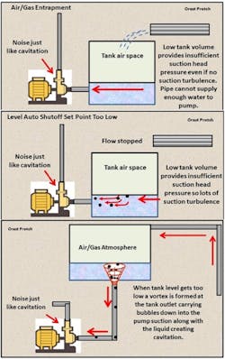

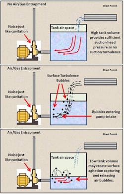

The top diagram of Figure 5 shows a tank where the inflow doesn’t create any turbulence that can cause bubbles to enter the outlet pump. If the inflow is so harsh that it causes severe surface turbulence on the liquid surface, then the flow of the liquid to the outlet pipe supplying the pump can carry the bubbles to the pump. This is illustrated in the middle diagram of Figure 5.
This liquid flow acts just like a Venturi and draws the bubbles with it. This can be caused if the tank is too small for the volume of liquids going through it or if the tank inlet pipe is too high above the surface of the liquid.
The bottom diagram of Figure 5 shows what can happen if the set point of the tank is too low before the feed pumps start up again or the VFDs are too slow to ramp up. Severe turbulence occurs. This is similar to the gurgling you hear when kitchen sinks start sucking air with the final volumes of dishwater.
Figure 6 illustrates more issues that can create cavitation in downstream pumps. The top diagram has a tank too large for the required flow if the level in the tank does not provide enough head pressure to force the liquid into the pump suction to satisfy the pump curve. Even though there may be no surface turbulence, the pump will cavitate due to feed starvation. This a big problem in many drinking-water treatment plants where tanks and pumps are below ground.
Pump starvation also can occur if the distance from the tank outlet to the pump inlet is too long, and the design engineers miscalculated on the diameter of the tank outlet pipe needed to meet the needs of the pump curve. I came across this issue a number of times in my career, especially in municipal water treatment plants.
The middle diagram of Figure 6 has a tank that controls inflow by level controllers and can have the same problem if the set point is so low that the pump inlet pipe gets starved and bubbles get sucked in. But in this case, the bubbles formed can be below the water surface, so they can be hidden from view.
The bottom diagram of Figure 6 has a non-pressurized tank supply pump that turns on and off due to level and also creates vortexes sucking in even more turbulence-created bubbles than simply poor head pressure. Anyone inspecting the pump vanes will likely see more damage than they expected. If they don’t properly identify the root cause, they could invest a lot of money on the wrong repair.
