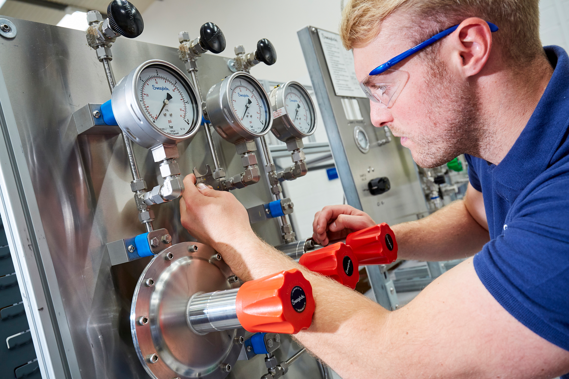

Gas pressure control panels typically include a complex array of tubes and pipes that are often arranged in unintuitive ways. This presents a problem for maintenance technicians who often struggle to access the components for repair. They end up having to disassemble multiple threaded connections and put them back together – a costly, time-consuming task that can lead to extended downtime. Also, technicians may encounter unlabeled valves or regulators, which can make ordering replacement parts challenging.
Reliability is essential in these systems because the gases are necessary for plants and laboratories to perform their basic functions. That’s why it’s important to fix any system deficiencies and make maintenance activities easier to perform. This may involve reconfiguring flow paths in your existing gas panels and using bendable tubing to reduce potential leak points and enable easier access to components. It may also include technicians tagging each significant component so they can quickly order a replacement when problems arise. Alternatively, a facility may choose to swap out its older systems with more modern gas pressure control panels, which typically require less maintenance than their predecessors. By adding such panels to systems, the cost of maintenance may be reduced significantly and directly affect a facility’s bottom line (Figure 1).
Simplifying Maintenance Through Optimized Design
In the past, gas panel designs have often located service-needy components in hard-to-reach enclosures or placed them behind pipes and tubes that must be taken apart to reach them. In such instances, maintenance technicians may struggle to understand how the gas panels work, which can interfere with their ability to provide appropriate maintenance. It can also increase the amount of time technicians must spend on panel maintenance that could be devoted to other areas in the plant.
Additionally, gas supplies must be curtailed to the location where service is being done, which leads to unplanned – and often unnecessary – downtime. Stopping production and testing to perform maintenance on gas panels is costly and can hurt facilities’ profitability.
In contrast, modern gas panels are designed with maintenance in mind (Figure 2). Frequently serviced components like regulators and pressure valves are easily visible to technicians and appropriately labeled so no guesswork is involved. Modern gas panels are built modularly, which means technicians can work on specific components of the panel without taking it out of service (Figure 3).
While a simple plug-and-play replacement with a new gas panel may be the most efficient fix for a hard-to-service legacy panel, facilities also have the option to reconfigure their existing panels to make maintenance easier. As an example, technicians may reroute tubing or use flexible hoses to enable easier access to other components. Such actions may be a more cost-effective approach when various panel components are still in good working condition with a long service life anticipated ahead. For example, if you’ve recently replaced a regulator in an older panel, you may prefer to make other adjustments to make the panel easier to operate, rather than take that regulator out of service just to replace it with a different one housed in a preassembled gas panel.
