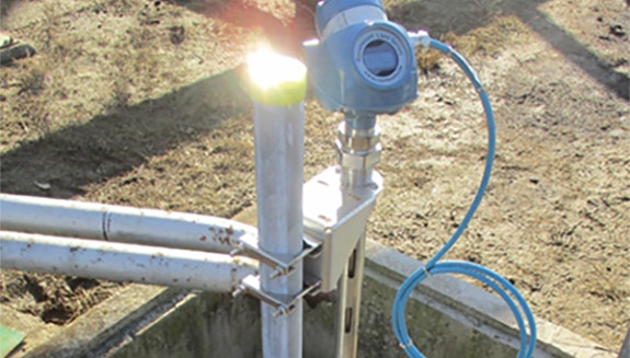

After considering the various proposals, the company selected Emerson’s Rosemount 5300 Level Transmitter, which uses guided wave radar (GWR) technology. In September 2019, it purchased 44 units for use on all secondary containment areas at the Antwerp facility (Figure 3). The installation also included a new WirelessHART network, with each area equipped with an Emerson Wireless 1410D gateway with 781 Field Link antenna, enabling the signal from the measurement points to go directly into the distributed control system (DCS).
Installed Level Transmitter
Figure 3. Site is using 44 of these transmitters for automated monitoring of secondary containment areas to provide greater visibility of potential leaks.

Because containment areas are open to the elements, there always is the potential for materials such as leaves or dirt to get into them, and for buildup eventually to stick to a transmitter’s probe, which can affect measurement consistency. To overcome this challenge, the Antwerp installation uses a large coaxial probe with no internal spacers, which makes it more resilient against clogging. This enhancement also provides protection against exposure to rainwater, which can impede the transmitter’s signal strength and impair the robustness of the measurement.
A dead zone at the very bottom of the probe typically limits the measuring range of GWR transmitters. This presented a challenge to detecting the presence of hydrocarbons in the containment area when the liquid level did not reach the bottom of the probe. However, a redesign of the large coaxial probe’s centering disk has enabled minimizing the lower dead zone in the Rosemount 5300 to just 20 mm for water and 50 mm for hydrocarbons — a 50% reduction from what was previously possible.
