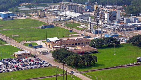

Plant management at the Honeywell Specialty Materials’ polyethylene wax production facility in Orange, Texas, wanted to maintain business continuity for manufacturing operations while abiding by social distancing policies. The plant was faced with pivoting its operational practices rapidly to deal with the challenges of today’s ever-changing environment.
The Orange facility had gone to a split-shift arrangement where half of its engineers were at the plant and the other half worked from home. The site needed a way for personnel to stay connected to process operations while working remotely. The goal was to limit the interaction between engineers and operators who were on site in the central control room.
