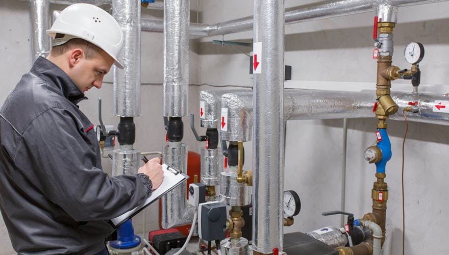

Digital transformation initiatives are more effective when starting with a problem in mind as opposed to leading with technology. This practical approach provides concrete results, encouraging further investment due to positive early returns. The alternative — picking an intriguing technology and then imposing it on a problem — often leads to failure. This is especially true when dealing with a key concern at chemical plants: the time, expense and safety issues posed by manual inspection rounds.
Highly skilled and increasingly valuable plant personnel often must perform these mundane and repetitive tasks, moving through the site to check the status of instruments and assets, and documenting their findings using pen and paper. These results then get manually entered into some type of maintenance management system, a process prone to data entry errors.
Applying digital tools to automate manual rounds frees these personnel to do higher level tasks such as analyzing collected data to improve operations. (Such worker upskilling is an essential element in any successful digital transformation.) In addition, cutting the time staff spend in the field reduces their exposure to risks posed by the process environment.
Automated data collection provides more consistent, repeatable and accurate measurements and allows much faster update rates, say, every 15 minutes versus once-a-shift or longer with manual rounds. The far shorter period between updates can enable plant personnel to more quickly catch and respond to condition changes.

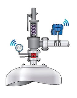

PRVs prevent overpressure conditions but, when actuated, may release hazardous pollutants into the nearby area. A plant must report these releases to the appropriate regulatory agency. If detection depends on a visible telltale signal, like a sock, that is inspected every eight hours, then the agency might assume the release lasted for eight hours. In contrast, an acoustic wireless transmitter (Figure 2) can provide 8-sec. update rates with long battery life, dramatically improving the timeliness of release reporting while also confirming the PRV has reseated and the release has stopped.
Safety and environmental bodies as well as insurance agencies often prompt compliance projects requiring more data from the field for monitoring purposes. In the case of PRVs, some environmental agencies no longer consider manual inspections acceptable and now mandate digital monitoring. After making a periodic inspection, an insurance underwriter may demand new monitoring points or secondary indication to mitigate risks related to asset health or worker exposure. In other cases, plantwide safety initiatives often require the automation of safety-related inspection rounds. Regardless of their source, compliance projects are mandatory, and wireless can dramatically reduce implementation cost and time.
PRV Status
Figure 2. Wireless acoustic monitoring device enables automatic remote monitoring.
In one application, an end user found the cost of wired PRV monitoring was $18,000/valve versus $3,000/valve with WirelessHART. Moreover, addition of the wired infrastructure only could take place during a turnaround whereas installation of wireless monitoring could occur during normal operations.
The project involved simply clamping a wireless acoustic monitoring device to the piping downstream of each PRV. All the devices were then joined to the WirelessHART gateway, which, in turn, was hardwired to the plant’s asset management system.
