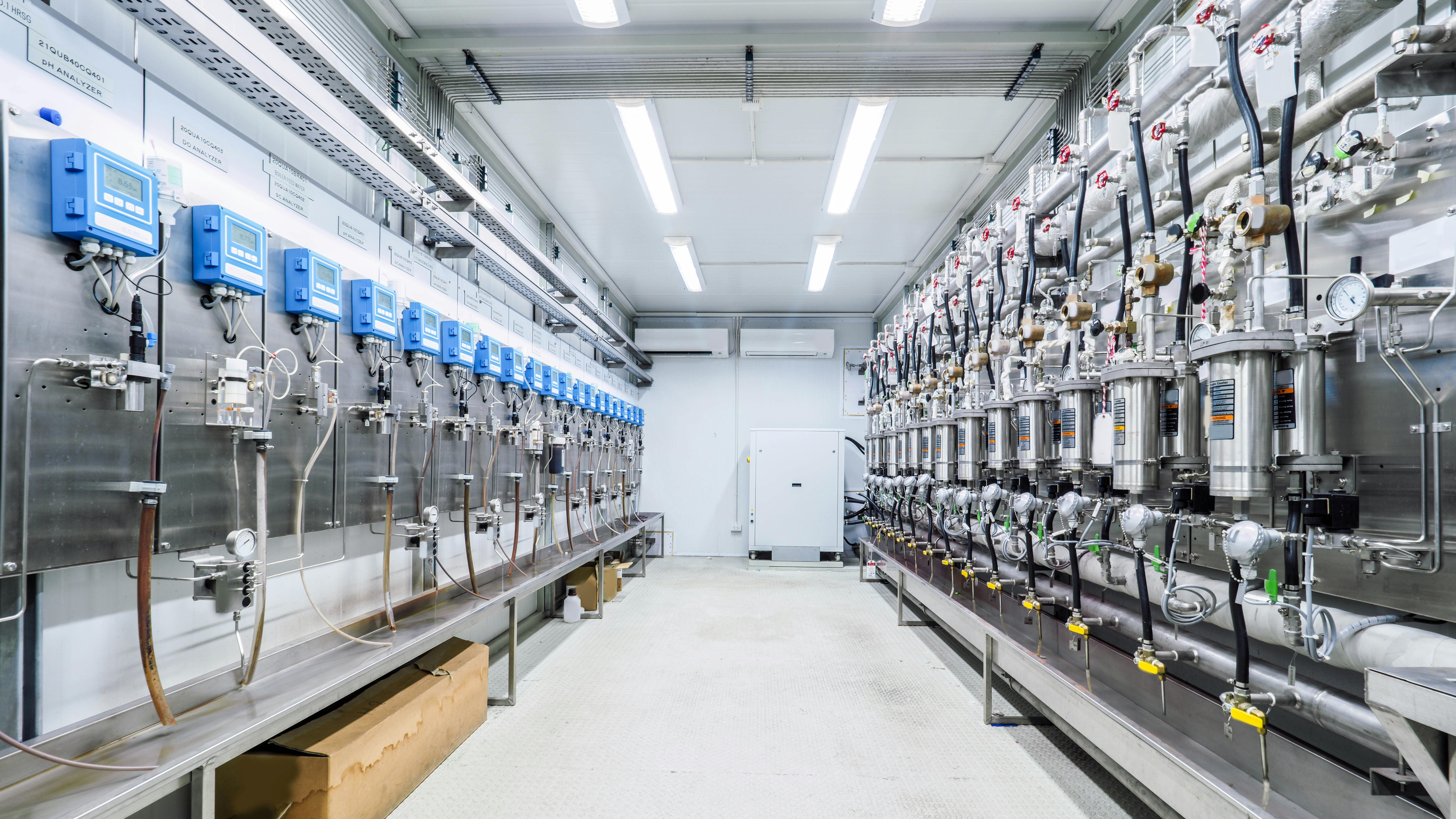

Process analyzer performance can benefit from access to information on the state of the sample conditioning system. Such systems can suffer from incorrect temperature, restricted flow, improper phase control, etc. These failings can result in delivery of an inadequate or inconsistent sample to the analyzer and, thus, can undermine the accuracy of a measurement.
Fortunately, development of a standard related to NeSSI (the New Sampling/Sensor Initiative) to foster adoption of miniature modular sampling systems now extends to communication between components of the sample system and an analyzer or controller. The second sub-standard of ANSI/ISA76.00.02, "NeSSI Generation II — Smart Systems and Communications Bus," defines a communication structure that enables the sample conditioning system to evolve from a mechanical component in the field requiring physical monitoring to a control element providing feedback for the benefit of the process.
The implementation of the ISA standard should spur the availability of more hardware to measure the sample system's pressure, temperature and flow as well as to control flow, etc., in the size and ranges needed for NeSSI systems. Importantly, the sub-standard is independent of the form factor specified by ANSI/ISA 76.00.02 and, thus, can be applied to components mounted in a traditional tube-and-fitting sampling system.
