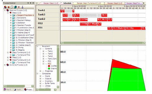

Simplified Model and Production Schedule
Figure 1. This high-level recipe uses water in place of most materials and a single operation for each unit procedure.

A high-level simplified process model was developed to capture the overall cycle time and yield of the relevant process steps. This model didn’t include all materials specified in the recipe. For example, water was used in place of specific process constituents; this allowed for both rapid model construction and acceptable accuracy (because the model isn’t used to carry out an overall material balance). However, the model structure would easily incorporate materials and other particulars to conduct a future detailed analysis if so desired.
Individual operations such as vessel charges, heating/cooling, material transfers and separations weren’t modeled. Instead, higher-level “unit procedures” (e.g., extraction or crystallization) were. Each unit procedure typically consists of just one or two operations, allowing modeling of the overall cycle time and yield for that procedure. This approach enabled rapid model development and, by using the integrated production planning and scheduling capabilities, quicker simulations of campaigns.
In total, over 150 scenarios were evaluated while capturing the essential information about the process. Figure 1 illustrates an example of the simplified model and production schedule.
