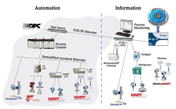

Fieldbuses are used to link field devices to control, monitoring and enterprise systems (Figure 1), which collectively I'll call the control system.

Figure 1. Delivering information directly to IT applications may provide a more-cost-effective alternative for some monitoring applications.

Go Direct
A field device usually is first connected to the control system via a fieldbus. The control system then is connected to the IT system through some type of middleware such as a database server.
However, for some field devices, particularly those involved in process monitoring as opposed to process control, direct connection between the field device and an IT technology platform may be a better solution (see Figure 1). This approach avoids the deterministic delivery, data management, safety and security issues associated with more-demanding control system environments.
Connecting directly from the field device to the IT system cuts costs substantially for three reasons. First, a direct connection eliminates the need for intermediate hardware components and software systems. Second, the field device in question may not need to be part of the control system's overall validation and maintenance program. Third, field device access can be controlled through existing IT security systems.
Many environmental applications such as EPA reporting and enterprise applications such as inventory management don't require the millisecond update speeds or deterministic behavior inherent to most control systems. Some facilities have found that up to 70% of their field devices don't have any associated real-time control functions.
Information from these noncritical field devices can be conveyed directly to standard networks and associated databases via wired and wireless field gateways. Not only is the primary information delivered in fully defined engineering units but device status also can be continually monitored and communicated on an event-driven or periodic basis.
Remote servicing tools and asset management applications working at the network level also can be used to configure and manage connected devices. Standard IT security and data management tools can be used to control access.
