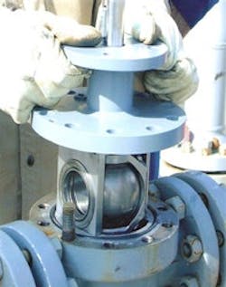

Metal-Seated Valve Employs Removable Cartridge
The Cartridge Valve is claimed to have a revolutionary mechanical-seal design for critical service applications. The valve uses aspects of ball valves, gate valves, and even triple-offset butterfly valves to protect the sealing surface during valve operation. A tapered hemispherical closure member (the hemi) rotates around a fixed core and wedges into a fixed seat to affect a mechanical seal. The closure member is rotated a quarter-turn by a valve stem that may be operated manually with a wrench or gear operator or automatically with a pneumatic, hydraulic, or electric actuator. It features a constant fixed core within the body to provide protection of the seating surfaces when the valve is opened, as well as minimizing turbulence as the valve is either opened or closed. The cartridge design affixes all the valve’s internal parts (core, hemi, seat, stem, bushings) to the bonnet and may be removed by unbolting the bonnet fasteners and lifting the cartridge from the valve body.
Hemiwedge Valve Corp. Inc.
(936) 539-5770
www.hemiwedgevalve.com
