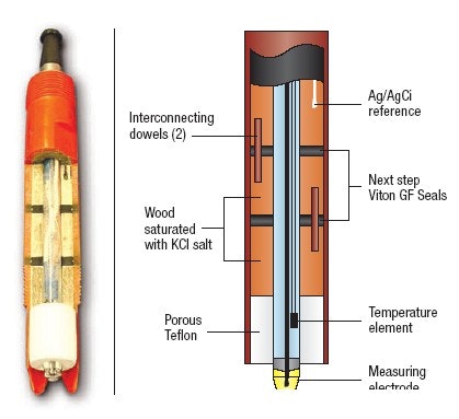

Eventually the plant found success with the TB557 pH sensor from ABB Instrumentation (Figure 2).
Figure 2. Teflon and Viton provides some protection against reference contamination.
This unit consists of a hot-tap retractable sensor, which allows easy insertion or removal through a ball valve without disturbing the process. The plant now uses the sensors on four batch reactors.
ABB supplies the sensor complete with a ball valve assembly that bolts to a standard flanged port on the reactor. The sensor has a patented reference comprised of a matrix of immobilized KCl salt fronted by a porous Teflon junction. This “solid state” reference is almost immune to poisoning or the plugging problems that plague conventional liquid, slurry and gel-based references. Without this reference technology the sensor would be quickly destroyed during batch operations involving vacuum and extremely high pH.
The ABB probe’s sensitive hemispherical glass electrode is rugged enough to withstand abrasion and strong caustic. It is rated for a true 0 to 14 pH range at temperatures to 140°C (284°F). The body of the sensor is Kynar (PVDF) strengthened by a titanium sheath; both materials hold up well to the harsh process conditions. An integral cable and temperature element complete this rugged combination pH sensor.
