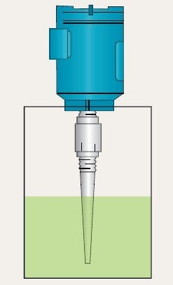

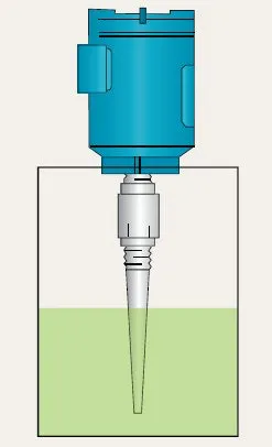

Ultrasonic. This technology works by providing voltage to a piezoelectric crystal that sends sound waves through the air to the liquid or solid surface where reflection back to the transducer takes place (Figure 4). The distance, which is proportional to the travel time, relates to level. Ultrasonic technology, because of advancements in electronics and echo-processing software, has become one of the best options for continuous level measurements.
Figure 4. Chosen for environments containing heavy dust or high humidity.
The technology measures from the top down; so there is virtually no contact with the contents of the container. Non-contacting technologies incur fewer problems with build-up, direct chemical attack and thus corrosion, and give a more consistent measurement. Ideally liquid should be homogeneous, with the temperature throughout the container fairly constant. In many cases, ultrasonic can measure solids, thanks to the ability of good signal-processing software and the use of flexible aimers for materials producing angles. Configuration, which was an issue years ago, now has become simple.
However, changes in vapor density, high dust content, foam, electrical and ambient noise, and surface turbulence can affect the speed of the transmission pulse. For instance, a heavy vapor cloud emitted above the liquid surface and creation of stratification layers will cause errors in the reading or produce a loss of signal transmission back to the transducer face. Ultrasonic cannot be used at temperatures exceeding 300°F.

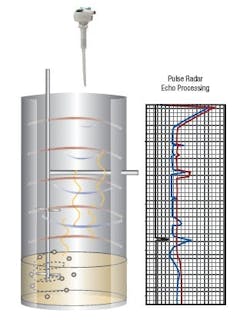

Radar. There are different techniques of propagating radar, such as pulsed and Frequency Modulated Continuous Wave (FMCW). Pulsed wave radar is similar to ultrasonic non-contact technology, but with the signal traveling at the speed of light instead of sound. In pulse radar, microwave signals are evaluated by a method of sequential sampling of discrete echoes over time (Figure 4).
The FMCW technique sends hundreds of thousands signals at different frequencies in a short time and compares those frequencies from transmit to reception, using Fast Fourier mathematics to determine level.
Measuring solids generally is the most difficult application for level; radar technology is becoming the norm for reliable measurement and dealing with the angles of repose of the material, dust in the airspace, and long-range readings.
The technology is non-contacting. Moreover, radar is unaffected by airspace conditions like humidity, heavy vapors, and vapor-layer stratification due to temperature fluctuations. It can perform measurements out to 230 ft. in conditions of heavy dust, which other technologies find very difficult. There are now two-wire, loop powered designs that offer low cost of wiring and ownership. Plus, prices have considerably lowered. For solids’ measurement, most radar transmitters will offer different antenna options. The horn (4 inches in diameter) is most widely used, but parabolic or dish type antennas also are available.
The accuracy of radar technology depends upon the dielectric constant of the material, which affects the reflectivity of the radar wave. A lower dielectric value (such as 1.5 compared to air’s 1.0) will lessen the amplitude or strength of the microwave signal reflecting back to the antenna mounted at the top of the vessel, making the measurement difficult. Radar cannot measure the interface of two immiscible liquids like oil and water. There also are pressure limitations for the antenna seal as well as temperature limitations at the flange area based on the material of the emitter, propagation tip or rod-style antenna.

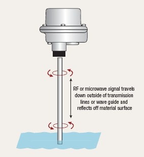

Guided wave radar. Sometimes referred to as Time Domain Reflectometry (TDR), this technology is similar to non-contact radar, except that it is invasive. Guided wave radar utilizes a flexible cable or various types of rigid probes and generates microwave pulses down the probe or guide (Figure 5).
Figure 5. This technology offers a measurement span that almost equals the vessel height.
When the signal meets the liquid or solid, it is reflected back, with the time from launch to reception a measure of the distance. Like non-contact radar, the amplitude of the signal depends upon the conductivity and dielectric value of the material. This technology has become very successful for measuring solids such as powders in hoppers and bins where the measurement range is 30 ft. or less.
Guided wave radar is unaffected by temperature, pressure or vacuum, and changes in the airspace with vapor. Additionally, the accuracy is independent of the material’s dielectric value, conductivity, density, and moisture content. Another distinct advantage is that calibration can be done without material being present. The technology tends to work well for short-range measurements. Because it has little top-end and bottom-end blanking, this technology can measure from near the top to almost the bottom of the container.
As a contact technology, it poses concerns about material compatibility, which sometimes necessitates expensive, exotic metals. Installation can be quite cumbersome with the rigid probe styles for liquid applications if head space above the vessel is limited. Additionally, the technology can be difficult, if not impossible, to apply to agitated vessels. In solids’ applications, there is a risk of the flexible cable being broken from too much loading of material weight. The loss of a guided wave radar cable into a powder-like material can cause heavy damage to a screw conveyor at the bottom of a silo. Also, abrasiveness of the material as well as excessive coating can cause damage and wear or false readings.
