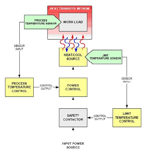

In its most basic form, a thermal system consists of the following primary components, as illustrated in Figure 1:
Figure 1. A system scheme for temperature control.
  • Work load — the fluid, to be heated or cooled (e.g., a liquid or gas);
  • Heat transfer medium — the materials and environment that must transfer heat to and from the work load (e.g., a vessel or pipeline);
  • Heat/cool source — a device that changes the input power source into heating/cooling energy (e.g., a band heater or chiller unit);
  • Process temperature sensor — an instrument that indicates the temperature of the work load (e.g., a thermocouple or infrared pyrometer);
  • Process temperature control — manages the temperature of the work load (e.g., a thermostat or electronic control); and
  • Power control — connects/disconnects input power to the heat/cool source as determined by the process temperature control (e.g., a thermostat or solid-state relay).
Some thermal systems require additional safeguards. If the system or process is not “inherently safe” (meaning it is capable of posing a hazard to people, equipment or the environment in the event of a malfunction), good thermal system design must  include the following secondary components, also shown in Figure 1:
  • Limit temperature sensor — provides a redundant or back-up indication of the temperature of the work load, the temperature of the heat/cool source, or both;
  • Limit temperature control — prevents the temperature of the work load from reaching a hazardous level; and
  • Safety contactor — an independent means of removing or disconnecting input power from the heat/cool source in the event a hazardous condition occurs.
