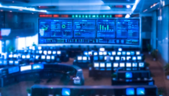

• The mission-critical operators have a work environment that’s comfortable, efficient, free of distractions, and optimizes situational awareness (Figure 1).

Efficient And Effective Environment
Figure 1. Putting the needs of the operator at the forefront of the design process leads to a control room that optimizes performance.
When designed properly, applying ISO 11064 standards, a successful control room gives the operators an environment of situational awareness suitable for timely response to issues. This equates to a safe, well-thought-out control room environment that should reduce incidents and allow operators to more easily react to and address any incidents that do arise.
