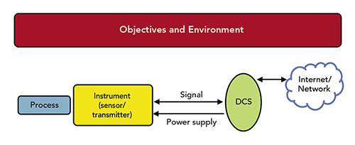

The Systems View
Figure 1 shows an example of systems to consider in the selection and installation of an instrument. You can assign as many systems as you deem necessary for a specific problem. Let’s look at the systems depicted in Figure 1.
Systems View Of Instrument Components
Figure 1. Considering the overall environment in which the sensor and transmitter function is important.
Objectives and environment. These are the top-level considerations. The objectives, for example, may be monitoring, operational control, process safety or environmental compliance; the stated aims collectively will influence cost and justification. Objectives also should address lifecycle, which includes long-term issues such as maintenance and calibration; special training or tools, if any, required; compatibility with the existing distributed control system (DCS) and future upgrades; and minimizing the cost and environmental impact of the system’s eventual retirement.

Process. This system considers the impact of the process fluid, operating conditions and the immediate environment on the integrity of the process signal reaching the instrument. Experience shows that most sensor and transmitter problems stem from inadequate attention to process systems.

Sensor and transmitter. Briefly put, the key objective of the sensor, which is the component in contact with process conditions, is to send a representative signal to the transmitter as quickly as possible. The transmitter then normalizes this signal to 4–20-mA, a digital value or another output. Today, a smart (digital) transmitter can provide, in addition to the current value of the process variable, a wealth of data such as device status, diagnostics and transmitter-specific information. Moreover, it requires fewer calibrations than an analog counterpart and facilitates remote calibration and troubleshooting. Figure 2 shows a schematic of a smart transmitter.

Signal and power systems. A number of issues can afflict these systems, including:

DCS and cloud system. Signals from the transmitter go to the DCS, which then responds to such inputs with outputs to control valves, solenoids, etc. With today’s modular systems, I/O or power availability for a control loop generally aren’t issues. Nonetheless, the DCS architecture should consider redundancy of I/O and power supplies as well as backup power. Diagnostic utilities available with most I/O systems ease configuration and troubleshooting.
The DCS now usually is part of an organization’s connected network. It communicates not just to the plant but also to corporate (e.g., enterprise resource planning), cloud storage and internet systems. This mandates close coordination between the operating technology and information technology groups.
