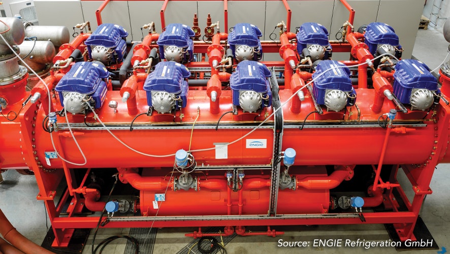

The first practical application of MTP standards in an industrial environment has just taken place at Evonik’s world-scale amino-acid plant in Singapore. It involved the integration of a chiller package.

Evonik, ENGIE, Siemens and Yokogawa worked together on this project to integrate a chiller package unit into a conventional production facility by means of the MTP standard (Figure 2). The MTP integration covered HMI aspects and communication aspects via OPC UA. The built-in controls of the chiller run in a monitoring-only mode, due to warranty issues between the package unit supplier, ENGIE, and the unit end user, Evonik.

The project involved the two automation systems: a Siemens S7-1500, the programmable logic controller (PLC) on the chiller package unit, and a Yokogawa Centum VP, the distributed control system (DCS) at the Singapore site. Figure 3 shows the steps in the integration. It took advantage of two prototype MTP tools — a modeler one and an import tool.

After tests in the lab had been completed, the package-unit PLCs and DCS were updated with MTP functionalities at the Evonik site. The OPC UA connection was configured between the Yokogawa UGS (universal gateway station) and the package unit network with the S7-1500 PLCs. Start-up took place in June 2019. The data transfer via OPC UA was established without error immediately after physically connecting the systems.
Operators were impressed by the quality of the HMI graphics, which maintained the same look and feel as those in the main process plant (Figure 4). Additionally, the graphics can be used and even modified like any other DCS graphic.
