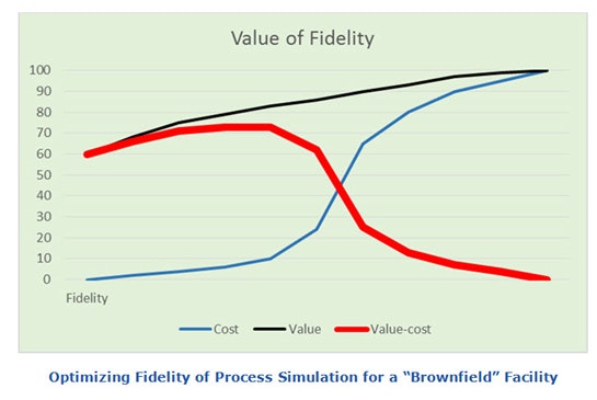

Value Of Fidelity
Optimizing Fidelity of Process Simulation for a “Brownfield” Facility
As shown in the graph above, the optimal process simulation from a value minus cost perspective tends to peak at lower model fidelities for brown-field facilities. The reason is that low fidelity process simulations can still be used effectively for training. Each plant may define fidelity differently or value fidelity differently so the optimal fidelity can vary. Higher fidelity of the process simulation can often be justified when you can reduce the cost of building and maintaining the simulation. Simulation vendors have made some progress doing this, but it is inherently difficult because real processes have so many complex parts that change behavior with time. As a result, many high-fidelity simulations developed for new facilities have been abandoned. Many existing facilities have upgraded to a new control systems, so training goals are skewed to learning the new control system with operators and workers that already know the real process.
