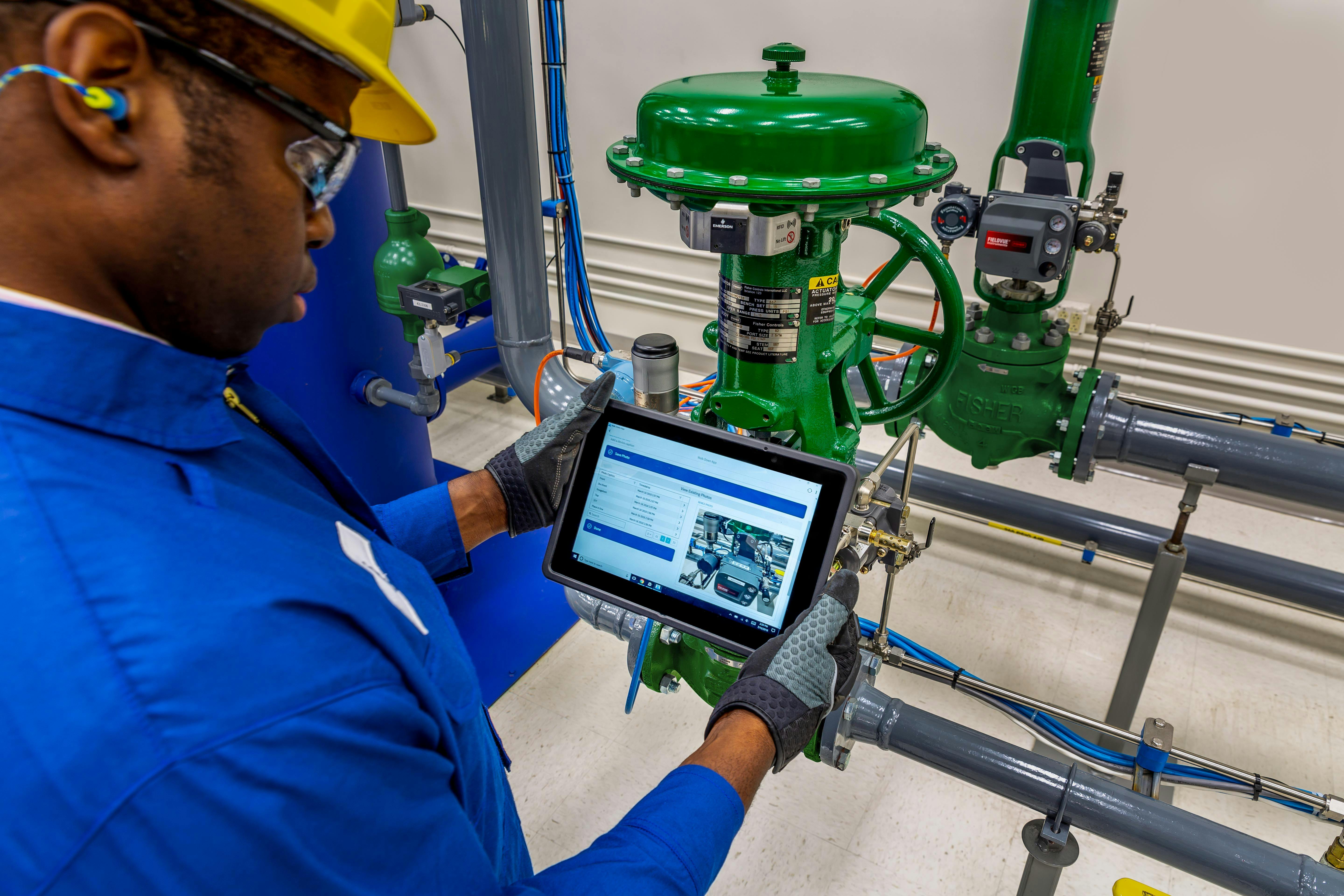

Start With A Walkdown
The first step is to understand what equipment the facility has. This most easily is accomplished by walking down every control valve to document specific details of each valve or to verify any available equipment data (Figure 2).
If this effort is being executed for the first time, it normally happens as much as a year in advance of the STO. If walkdowns have occurred in the past, then the effort required is reduced and the walkdown can take place closer to the turnaround date to obtain the most-up-to-date information. It is wise to place early focus on potential long-lead items, such as valves with exotic alloys or customized internals, to enable ordering replacement parts or valves well in advance.
Plant personnel can perform this effort if they have the time and expertise; partnering with a valve vendor is another option. A critical aspect of the process is to use a method of reporting that encourages consistent and complete data gathering while saving information in a method that can be easily referenced and updated. Some vendors offer applications and handheld devices that aid technicians in efficiently gathering the required information. It also helps to assign each valve a sturdy RFID asset tag to allow easy access to its information as the valve progresses through repair and installation.
Many plants also use the walkdown as an opportunity to address fugitive emissions. Valves handling volatile organic compounds and other targeted or restricted materials are specifically identified and evaluated for emissions during the initial valve review. Then, a check of the leak histories of these valves leads to flagging any valves that have shown persistent fugitive-emission problems.

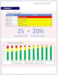

Most control valves incorporate digital positioners to improve valve response and control. Many of these positioners can gather performance data that can indicate when a control valve is developing problems. There are a couple of ways to obtain this information. One option is to perform a stroke test when a valve is commissioned and then compare that information to current stroke data to identify inconsistencies (Figure 3).
This method, which can be quite effective, does not provide real-time feedback on how a valve is performing while in service. To obtain that level of data, the plant can leverage the diagnostic data that already may be available in the positioners. Recent-generation digital positioners can detect a wide variety of issues including packing problems, air supply troubles, developing trim failures, and a host of actuator and control concerns.
A positioner that communicates to a control asset-management-software package can flag and alarm these issues. Resource-constrained plants can safely transmit this information to external automation experts, who can review the information — highlighting developing problems in periodic reports (Figure 4) and flagging serious problems that require immediate attention.
All these diagnostic data are invaluable for STO planning — enabling flagging valves with developing problems for repair and identifying high performing equipment that can be left alone.
Remote Review
Figure 4. Outside experts can monitor valve diagnostic data and highlight developing problems as well as serious issues demanding immediate attention.
