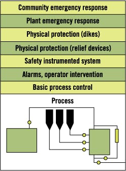

Multiple safety layers
One common theme in all of the industry's process safety documents is multiple independent protection layers. Instrumentation and controls form many of these layers. See Fig. 1.
Figure 1. Independent Protection Layers
Historically, all of the layers were independent, typically using diverse technologies from diverse vendors. However, with the acceptance of software programmable systems, many plant engineers have considered combining multiple functions into one system. For example, it is possible to combine control, alarms, shutdown and fire and gas systems in a modern DCS.
The benefits seem obvious ," single source of supply, simplified training and spare parts, lower installed costs, etc. ," yet all industry standards either outright forbid or strongly frown on such practices. The reasons are simple. How do you allow access to some functions, but deny access to others? How do you enforce management-of-change policies when operators are constantly making changes to the control system? How can you be certain changes made in one program area will not impact the functionality somewhere else?

The benefits of multiple independent layers also can be shown graphically. Consider an example of a process with an inherent level of risk ," in this case, the probability of an explosion ," of once per year, (as was common in the manufacture of gun powder more than a century ago). Such a level of risk would not be tolerated today.
Suppose the current goal was a 1/100,000 chance of explosion. Assume the basic process cannot be changed. The only alternative would be to add multiple independent protection layers. See Fig. 2.
Figure 2. Risk Reduction
The "mechanical" layer might represent pressure-relief valves, and the "other" layer might represent a fire and gas system. Some layers are "prevention layers," installed to prevent a particular hazard, while others are mitigation layers, installed to lessen the consequences of a particular incident. Assume each layer reduces the risk by a factor of 10. The original accident probability of once per year now can be reduced to 1/100,000 per year (10 x 10 x 10 x 10 x 10 = 100,000).
But what if most of the layers were performed in a single box such as a basic process control system (BPCS). In this case, the overall risk would be reduced only by a factor of 100 (the control system and the mechanical protection [10 x 10 = 100]). The overall level of safety protection in this scenario is less by a factor of 1,000, even though a modern control system was used. Industry standards actually limit the performance operators can claim from a control system to no more than a factor of 10.
