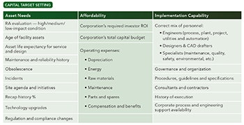

Table 1. A capital budget should reflect an appropriate tradeoff among three factors.

The actual determination and setting of capital budgets for a site becomes a balancing act between three factors: asset needs, affordability and capability (Table 1).
Asset Needs. As described earlier, knowledgeable personnel from operations, engineering, maintenance and other groups must evaluate the physical state and capability of the facility and equipment assets. This is the main asset factor in setting the capital target (CT). However, other less important characteristics of the “whole site asset portfolio” in general require consideration. These include: age of assets versus life expectancy, maintenance history, asset-related incidents, recapitalization history and change related to compliance, regulations or available technologies. This evaluation should occur on an annual basis, but timing could differ given a site’s unique circumstances. Evaluations result in recommended actions or a capital project investment list.
Of course, at some point each individual project recommendation should undergo a business case evaluation with a risk/benefit discussion because every investment must stand on its own merit.
Occasionally, you’ll find an asset that never seems to get to a replacement state yet that poses increasing risk as it ages. Rating such an item becomes much more difficult; thus, it requires careful monitoring for increased failures or deterioration.
In the end, each asset (and, sometimes, system) must get a high-, medium- or low-impact condition rating. Where needs exist, the appropriate personnel then must estimate the project cost to remedy the situation. Usually, this is a planning or cost opinion estimate only, showing which year(s) the capital need is anticipated.
Affordability. The financial organization within a company usually dictates an overall capital budget based on bottom-line forecasts of profit and return for investors. This takes into account product sales, initiatives and profit projections as well as other internal and external influences. Unless there’s a new product, merger or acquisition, this overall capital budget only changes slightly from year to year. However, engineering can provide input data from the recapitalization evaluation that may influence the total capital budget financial adjustments from year to year.
Business units within a corporation will go through a very similar analysis because they usually are separate profit centers. In addition, specific sites develop their own longer-range strategic plans. From this overall process, the yearly business plans evolve. The details of a business plan will include the operational expenses as a result of capital spent from projects and initiatives including depreciation, energy, maintenance, raw materials, spares/parts and personnel compensation/benefit needs.
Implementation Capability. For capital spend, the best indicator of future performance is past performance. Unless a site changes its organization or processes, performance results from investments will be similar from year to year. Thus, the number of projects and capital spend are a good predictor of the site’s implementation capability. To substantially change that, you must evaluate the agenda and initiatives in terms of both internal and external resources including: internal engineering (process, plant, project, utilities and automation) and specialists (e.g., maintenance, operations, quality, safety, environmental and logistics). Additionally, appropriate SMEs, internal or external consultants, contractors, vendors, etc., must be available.
Always keep in mind that capital plan implementations often fail when workload issues stop a particular engineering group from devoting sufficient time to properly develop, define and help engineer the project details to the level needed for success. These “discipline bottleneck areas” tend to arise where resources sometimes are lacking, e.g., if a particular technology has evolved to the point where it requires more resources than in the past. Inadequate analysis and insufficient level of support put the efficiency and success of a larger capital plan substantially at risk. However, corporations often will give sites with proven performance the flexibility to run larger and larger projects on their own (with some guidance or procedures to follow and report on).
