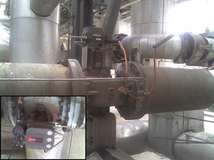

Figure 1. Unit features reliable and accurate linkage-less, non-contact valve-stem feedback technology.
A team of SECCO instrument engineers, together with engineers from Star Controls, the local business partner of Emerson Process Management, studied the problem. After careful consideration, the team decided to install a Fieldvue DVC6200f digital valve controller. The unit features linkage-less non-contact position feedback and Foundation Fieldbus communication capabilities. Instead of relying on a physical connection between the position-sensing element and valve stem, the new device uses a magnetic array to detect valve stem position. Thus, it can tolerate high levels of vibration. Emerson supplied the mounting kit for the non-Fisher valve and actuator assembly involved.

We installed the Fieldvue DVC6200f unit on the troublesome valve in March 2010. The instrument continues to perform with good accuracy and reliability. By eliminating the need for replacement every three months, the device has paid for itself many times over since installation. Based on the performance of the DVC6200 in this application, we have installed three more units.
