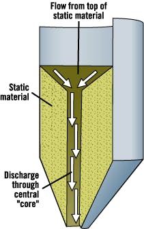

Vessels used to store and discharge particulates into the plant process or packaging equipment must be designed and constructed correctly. Plant engineers should gain an understanding of two basic discharge patterns before purchasing a vessel: core flow discharge and mass flow discharge. See Fig. 1 and Fig. 2.
Figure 1. Core Flow Discharge
Core flow vessels feature convergent wall angles between 45 degrees and 30 degrees.

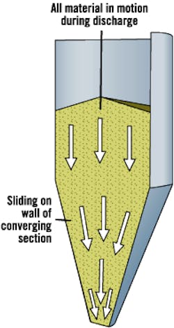

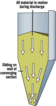

Figure 2. Mass Flow Discharge
A mass flow vessel is designed to encourage material to shear at the walls during discharge.

In contrast, a mass flow vessel is designed to encourage material to shear at the walls during discharge. The vessel typically features steeper wall angles of greater than 25 degrees from the vertical. Material flows from this type of vessel by gravity alone, on a "first in, first out" basis. Therefore, a mass flow vessel is intrinsically better suited to time-dependent materials.
Because the material is discharged evenly across the cross sectional area of the inventory, this vessel also can reduce the effects of radial segregation, which might otherwise create variations in blend ratios or bulk density values. This type of vessel requires outlet sizes that are typically one-third the size of those required for reliable operation of a core flow vessel, and has the added benefit of operating reliably by gravity alone.
The even draw-down of material also permits a degree of deaeration, or maturing, of product before the product reaches the outlet. A core flow vessel, in contrast, draws the fresh material down the preferential channel, giving rise to flushing or severe bulk density variations.

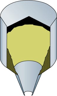

A misunderstanding of the flow properties of bulk solids can lead to the misapplication of various vessel designs. The expanded flow bin shown here had been continually replenished without allowing to drain down to empty. As a result, material accumulated and aged in the upper funnel flow section. The benefits of the mass flow lower cone (acting as a feeder with an effective inlet size beyond the arching dimension for the bulk solid) were negated by the limitations of the operational usage rather than the intrinsic design of the vessel itself. This problem is common and can be overcome through the careful understanding of the properties of the bulk solid and applying that knowledge to the equipment specification and operation.

When free-flowing materials are present, the flow channel can expand to intersect with the vertical section of the vessel. This type of discharge pattern gives a "first in, last out" material discharge, which might not present an issue with many materials. However, in situations involving the storage of time-dependent materials, this discharge pattern can be a significant issue, particularly if the vessel is continually "topped up." The vessel shown in Fig. 1 offers the type of discharge pattern seen most frequently in standard "off-the-shelf" equipment. This type of vessel typically will feature convergent wall angles between 45 degrees and 30 degrees from the vertical, and will have an outlet dimension that has been determined by the inlet requirements of the feeder to be installed under the vessel. Once discharge from the vessel commences ," assuming flow can be initiated ," a preferential flow channel forms that extends from the outlet to the top surface of the stored material (in the case of moderately fine materials).
