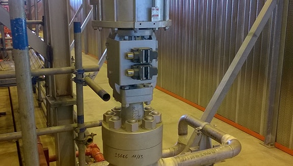

Figure 1. This piping, shown during construction, requires careful stress analysis to ensure it can cope with attached equipment.
