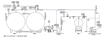

Our refinery sells propylene to a polymer manufacturer. The railyard loading system (Figure 1) at the edge of our site usually gets little attention; I reckon it largely has been ignored for decades. However, the system drew management notice when we went through a patch of extremely cold weather. The frigid temperature caused the air lines to the control valve to plug when moisture in the lines froze. When I went to sort out that issue, the foreman was eager to share his other troubles: 1) the pump vapor-locks; 2) the compressor starts and stops too frequently, leading to too rapid replacement of the motor starter heaters; 3) the pressure relief on the compressor pops open often and sticks open; 4) the measurement from the orifice plate is erratic; 5) the pump frequently must go to the shop, mostly to replace seals and bearings; and 6) units at the refinery can’t agree on an outage schedule to allow shutting down system for cleaning and maintenance. What can I suggest to improve this operation?
Propylene Loading
Figure 1. Long-neglected system is suffering a variety of problems.
