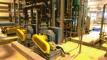

Figure 1. One blower is operating while the other serves as a standby.

Spare parts and redundancy are important for critical components such as lubrication oil pumps, oil filters, oil coolers, etc. Storing individual parts of a component in a warehouse is fine but an entire unit, such as a spare lubrication oil pump, should be installed as a standby rather than kept in a warehouse. Sometimes, installing a redundant blower is wise (Figure 1). Standby units require regular monitoring to ensure they will work when needed.
