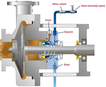

API Plan 62
Figure 1. This approach consumes a lot of water, which flows through the seal and directly discharges into drain.
Choosing the wrong plan can undermine a processor’s efforts to maintain a high level of hygiene. The conventional seal support system frequently harbors dirt and bacteria on the interior of its main vessel; the inherently enclosed design hampers inspection, cleaning and maintaining high levels of hygiene. Therefore, for all hygiene-sensitive operations, a processor should select an alternative system designed to ease proper and effective cleaning procedures.
Common Choices
In many applications, following an API plan is an efficient and effective method of ensuring optimal operating conditions for the seal. One of the simplest forms of seal support system, API Plan 62, runs water through the seal and discharges it directly to a drain (Figure 1). This plan can provide a more hygienic method of maintaining the mechanical seal and often is found in processes that require a higher level of cleanliness. However, it is inherently expensive to operate due to the continuous high volume of water required (as much as 700,000 U.S. gal or 2.6 million L per year), potentially resulting in a lower mean-time-between-failure (MTBF) rate. Obviously, this has significant implications both on the running costs of the process and environmental concerns about water wastage.

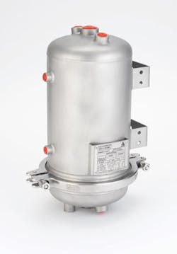

API Plan 53A
Figure 2. By using recirculation, this approach can cut water consumption by more than 99%.
An alternative solution is API Plan 53a (Figure 2). This layout utilizes a vessel to provide the seal with a constantly recirculated flow of a fixed volume of water. It can operate using a thermosyphon effect, whereby convection causes hot fluid to rise up out of the seal and draws in cooler fluid.
API Plan 53a can reduce water usage by more than 99% compared to an API plan 62 design, and has been shown to improve the MTBF of mechanical seals. When used to replace an API Plan 62 system, API Plan 53a can provide a return on investment of less than 6 months.

A two-part vessel is part of the latest development in water and oil API plan 53a barrier-fluid-management systems, and is aimed at environments that require a higher level of cleanliness. Its design allows the lower section to be quickly and easily opened, enabling inspection and cleaning, if needed, of the internal cavity (Figure 4). It has been shown that a two-part vessel design in an API Plan 53a arrangement, coupled with a scheduled inspection and cleaning program, can prevent contamination from the process and bacterial growth.

This option helps avoid product contamination, reducing the chance of product rejection or even recall. In addition, a two-part vessel can be manufactured to minimize the possibility of bug traps by using filler welds, a custom-designed gasket and a sediment pipe to ensure particulates aren’t introduced into the thermosyphon stream.
Two-Part Vessel
Figure 4. Removable bottom section enables quick inspection for contamination and facilitates any needed cleaning.
The seal feed line usually is positioned at the lowest point of the vessel. However, it is far more effective to introduce the sediment pipe feed higher up the vessel, which greatly reduces the risk of particulates re-entering the barrier fluid line and, ultimately, the product.
Other features also can help maintain a high level of cleanliness. For instance, a clean-in-place (CIP) attachment can ensure the internal surfaces of the vessel are clean and free from unwanted deposits. This is a special fitting that screws into the top of the two-part vessel and includes a CIP ball. In cleaning operations, the appropriate fluid is pumped through the attachment and the ball gives 360° coverage, at pressure, around the internal surfaces of the vessel.
