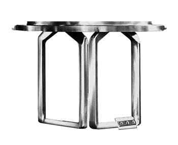

Double Planetary Mixer
Figure 1. Two rectangular stirrers that rotate on their own axes as they revolve on a common axis move through the batch continuously mixing materials up to about 2 million cP.

The double planetary mixer (Figure 1) is designed to mix materials that are sticky and don’t flow easily. Its stirrers move through the batch in a planetary pattern while they rotate on their own axes. They physically transport material from the vessel walls into the vessel interior, mixing the batch thoroughly in only a few revolutions. This action promotes efficient dispersion — and, with bottom- and sidewall-scrapers added, efficient heat transfer as well.

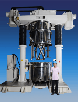

Batteries Power Drive To Massive Mixers
The strongly rising demand for lithium-ion (Li-ion) batteries is spurring big increases in production capacity in China. The equipment for a typical battery process line costs more than $30 million. The planetary/disperser hybrid mixers on the line commonly operate with batch sizes of 300 gallons or more (Figure 5) but 750-gallon planetary mixers are coming online soon and 1,000-gallon ones are not far off. Battery manufacturers are moving toward these extremely large batch sizes both to lower the risk of batch-to-batch inconsistency and to capture economies of scale.
Immense Mixer
Figure 5. This 300-gallon unit is used for lithium-ion battery production in China; 750-gallon mixers will be online soon and even larger devices are coming.
This process environment requires a high-viscosity mixer capable of delivering both great power and versatility. In the initial phase of Li-ion electrode production, known as dry kneading, the mixer must blend dense, nano-sized powders with its helical planetary blades. Four high-speed disperser blades also are turning at low rpm and moving through the batch in a planetary pattern, but the planetary blades are doing most of the work. Viscosity during this period exceeds 5 million cP.
Dry kneading continues for another hour with the addition of a small amount of adhesive binder. The helical blades push the sticky batch material down and forward, applying high shear as they advance through the vessel.
A solvent then is added. As viscosity falls, the batch becomes more flowable. Soon the planetary blades no longer are the primary source of shear. The independently driven high-speed disperser blades accelerate and disperse the pre-blended powder blend into the solvent. By the time the cycle is finished, after about four hours overall, the electrode slurry has been let down to a viscosity appropriate for coating — between 5,000 and 15,000 cP.
