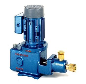

Piston Pump
Figure 1. A small gearbox powered by an electric motor drives this single-acting plunger pump. Source: Grosvenor Pumps.
This article focuses on piston and diaphragm pumps and presents practical guidelines on the selection and operation of these metering pumps in chemical processes.

Piston Pumps
These positive-displacement devices can be designed to pump at practically constant flow rates (averaged over time) against a wide range of discharge pressures. Such pumps produce pressures to 700 Barg; special types can achieve pressure above 1,000 Barg. Figure 1 shows a single-acting piston pump.
Generally in such pumps, a piston (sometimes called plunger), typically cylindrical, goes in and out of a correspondingly shaped chamber in the pump head. Packing around the piston or a doughnut-shaped seal with a toroid-shaped sphincter-like spring inside that compresses the seal around the piston usually holds the fluid pressure when the piston slides in and out and makes the pump leak-tight. The packing or seals can wear out after prolonged use but can be replaced. The potential for wear and subsequent leaks makes piston pumps a bad choice for abrasive fluids.
A single-piston pump (Figure 1) delivers liquid to the outlet only during the discharge stroke. If the piston’s suction and discharge strokes occur at the same speed, liquid is metered out half the time the pump is working; so, the overall metering rate averaged over time equals half the average flow rate during the discharge stroke. Some single-piston pumps feature a constant slow piston motion for discharge and a quick retract motion for refilling the pump head. For such devices, the overall metering rate practically equals the pumping rate during the discharge stroke.
