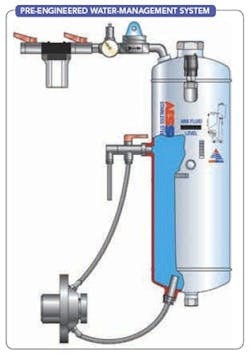

Delivery of the water barrier fluid is important to application success. Traditional piping configurations are API Plan 53-A and API Plan 54. Plan 53-A is limited by a fixed volume of barrier fluid; a fluid-containing vessel or "seal pot" is externally pressurized by air or nitrogen. During process upset conditions, the pressurized volume of fluid crosses the inboard seal face, and the seal pot must be recharged during operation. This recharging process is not operator-friendly — so there's high likelihood the seal will run dry. Plan 54 is a centralized water-barrier distribution system, usually through multiple pumps. This means the circulating system always must be pressurized 15 to 30 psig above any seal chamber pressures to avoid cross contamination of the barrier fluid.
A DUAL MECHANICAL SEAL
Figure 2: The space between the sleeve and the inside diameter of the two sets of seal faces is filled with a pressurized barrier fluid — usually clean water.Leading processors have had success with hybrid solutions whereby Plans 53 and 54 are combined and water comes from a self-contained water management system (Figure 3). The system is designed to control pressure and cool the seal faces; it uses a regulator and a backflow preventer to set the correct water-barrier pressure for the seal faces. The water is recirculated, reducing actual consumption to just a few gallons per year. An inline filter connected to the continuous source of water filters the barrier fluid to 1 micron absolute. A three-way valve in the line returning from the seal to the reservoir enables the operator to inspect the condition of the barrier fluid in the seal without compromising seal performance. Should any particles cross the inboard seal face, the three-way valve is activated to flush the seal. An internal standpipe on the supply line to the seal protects the seal from contaminants. By connecting a valve and drain line to the bottom of the tank, an operator can purge contaminants from the reservoir while the connected water source automatically replenishes the system with clean water. If process air bubbles accumulate at the seal face, the secondary liquid provides sufficient cooling to ensure consistent seal performance. The size of the seal pot and the positioning of the inlet and outlet ports determine the level of heat dissipation by the support system. Independent control of the seal environment broadens the success margin for the seal.

PRE-ENGINEERED WATER-MANAGEMENT SYSTEM
Figure 3: A self-contained system can supply water for dual mechanical seals while minimizing makeup water.• The mechanical seal must be a heavy-duty dual-cartridge mechanical seal suitable for slurry duty and designed to operate at all times at a higher pressure than the process pressure. • Seal internal cross-sections must have large radial clearances; the inboard face set must be hydraulically balanced to the barrier fluid. • Tungsten carbide (TC) and/or silicon carbide (SiC) faces matched with solid TC faces must be used when the pH is greater than 5; solid SiC must be used when the pH is 5 or less. Pin drives must be designed to minimize face fracturing. • Wetted alloys must be super duplex for abrasion resistance. • Mechanical seals must perform equally with or without impeller back-vanes; the user requests that back-vanes be incorporated in the equipment impellers. • The seal chamber must be an open-frame plate liner with vortex breakers or a closed-frame plate liner designed to prevent excessive erosion. • A mechanical seal support system must be provided as a pre-engineered turnkey system; it must include all instrumentation and fittings necessary for site installation. • The tank must have a minimum capacity of 25 liters (6.6 U.S. gallons) and be self-filling. Inboard seal face integrity must be visually confirmable at the support system with a flow indicator. • The distance between the seal supply and return port should be a minimum of 15 inches to maximize residency time for barrier-fluid heat dissipation. • The system at all times must deliver barrier fluid at pressure differentials 15 psig (minimum) above the process pressure in the pump stuffing box. • The seal system must include inline filtration of plant seal water to 1 micron. An internal standpipe on the supply leg, a three-way valve on the return leg, and a blowoff valve at the bottom of the tank must be included to allow clearing the system of any contamination after the initial installation and during its service life. • As part of the initial supply package, documentation must include a heat generation report for each installation. The report must refer to the operating conditions for the intended shaft diameter, speed, process/barrier pressure, temperature and induced flow. The data must provide the input for a thermal equilibrium estimation and result in a calculation of the heat generated by the specific seal supplied in each case.
