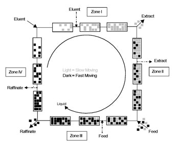

The classic SMB chromatography process separates a feed stream containing two or more dissolved solutes into two effluent streams — a stream rich in the relatively slow-eluting solute or solutes (called the extract) and a stream rich in the faster-eluting solutes (the raffinate). An SMB process approaches the efficiency of a true countercurrent solid/liquid process while avoiding problems associated with particle movement. Compared to standard pulse injection (batch) chromatography, SMB operation minimizes product dilution and maximizes productivity of separation media. It can't improve purity or recovery achievable by batch operation but offers much greater operating efficiencies that dramatically reduce capital and operating costs for commercial-scale implementation.
Basic Process Scheme
Figure 1. This arrangement typifies four-zone SMB operation. Source: Ref. 7, used with permission from AIChE.A typical process utilizes six to 20 fixed-bed columns or sections of columns. The basic SMB processing scheme involves switching the position of each column through four operating zones (Figure 1). In conventional SMB operation liquid flow rates are steady but in some advanced versions feed and solvent rates change within each cycle. The four SMB zones form an internal loop in which the key slow and fast eluting solutes move in the same direction but at different rates. The inlet and outlet positions for feed, solvent, raffinate and extract move in the same direction through the sequence but at a rate between that of movement of slow and fast solutes. This means that slow and fast solutes move in opposite directions relative to inlet and outlet ports, clockwise or counterclockwise around the loop. Most separation occurs within Zones II and III. Zone I prevents the slow eluter from falling too far back toward Zone IV and into the raffinate outlet. Zone IV stops the fast eluter from going too far forward into Zone I (thus becoming lost in the extract). Elution solvent is added to Zone I to accelerate the slow moving solute to prevent it from falling backward into Zone IV (where it would be lost in the raffinate). For simplicity, Figure 1 shows an equal number of columns allocated to each zone. However, because most of the separation must take place in Zones II and III, these zones generally get more columns, as in a 2-5-4-1 configuration: 2 columns in Zone I; 5 columns in Zone II; 4 columns in Zone III; and 1 column in Zone IV. Figure 2 is a standard SMB plot showing concentrations of bovine serum albumin (BSA) and equine heart myoglobin (EHM) solutes (sampled at a specific time into each step) as a function of column sequence number. This is the position relative to the beginning of Zone I, shown here for a 2-5-4-1 configuration. Brackets with labels indicate where feed and elution solvent are added to the loop and where raffinate and extract are removed. Solute concentrations in the extract and raffinate streams change dramatically over the course of a single step, as illustrated by the bracketed ranges. FLOW RATE REQUIREMENTSFor economical operation, liquid flow rates must be carefully adjusted to obtain desired separation while minimizing solvent consumption. Flow rates are regulated to prevent slow and fast eluting solutes from lapping each other and to generate an internal profile in which, ideally, essentially all of the fast eluter exits in the raffinate and all of the slow eluter exits in the extract. For simplicity, consider a system with only two solutes, a fast eluter A and a slow eluter B. Starting with Zone II, liquid flow rate is chosen so the majority of A moves forward (clockwise) into Zone III but flow rate is limited so the majority of B doesn't enter Zone III. In Zone III, liquid flow rate is selected so B barely moves backward (counterclockwise relative to the inlet and outlet ports) and thus A (being faster) will continue to move forward. Flow rate in Zone III always will exceed that in Zone II because in Zone III flow rate equals the sum of flow rates of Zone II and the entering feed. Zone IV uses the slowest liquid flow rate — chosen to be just slow enough to prevent A from moving from Zone IV into Zone I. It should be no slower than necessary, as this yields a more economical operation because more solvent will be recycled into Zone I, reducing need to add fresh solvent. Zone I uses the highest flow rate, to stop B from falling behind. Flow rate is selected to be just fast enough to force B to move forward. Making this flow too fast requires excess elution solvent. Pulse tests can serve to estimate SMB flow rates. Optimal pulse test uses a single column of the same length and filled with the same media as envisioned for the commercial scale. For economical commercial-scale operation, particle diameters typically are on the order of 200 to 350 microns to avoid excessive pressure drop [5,7]. A column of 0.5-in. (1.3-cm.) diameter or larger is needed to avoid significant wall effects. To provide adequate separation performance with the larger particle diameters, column length usually is at least 3 ft. (approximately 1 m).
