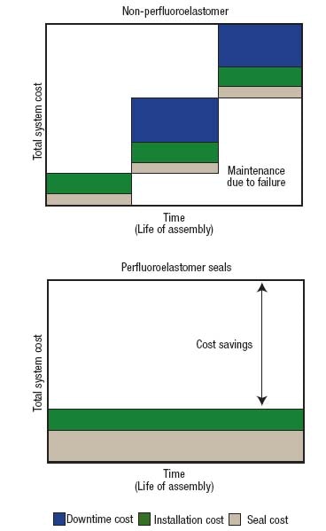

Price isn’t the controlling factor for the second scenario (Figure 5). Seals are replaced due to failure or for maintenance reasons once or twice during the life of the equipment. Failure incurs the expense of unplanned downtime. Using perfluoroelastomer seals could be the most-cost-efficient solution.
Figure 4. Using a more expensive perfluoroelastomer material pays off if it avoids unscheduled downtime.

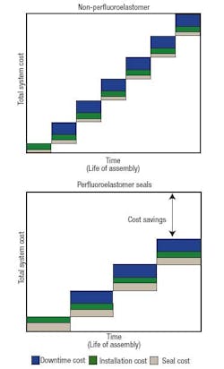

In the third scenario, the seals need to be replaced several times. Perfluoroelastomers should offer substantial savings because in process environments involving elevated temperatures and aggressive chemicals they should last longer than conventional sealing materials.
When seal replacement is regularly scheduled for reasons of safety, service, quality or economy, the downtime cost incurred in replacing existing seals is usually constant (Figure 5). The added expense of switching to perfluoroelastomer seals should be offset by doubling, tripling or even quadrupling the periods between overhauls.
Figure 5. Longer time between overhauls should offset the added cost of a perfluoroelastomer seal.
